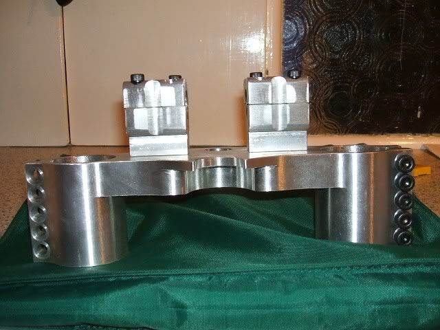

I stuck a set of k5 thou forks in my old Bandit 1200 They're now in this-

Pressed stem out of B12 yokes & pressed it into thou bottom yoke. made up a spacer for the front wheel, & made up some brackets for the lights, clocks etc. I found that the bike felt like the front tyre was always under inflated so i had Pingu make this :wink: Oh & most easterly point -

Quote from: gixxerboy;392098
I found that the bike felt like the front tyre was always under inflated so i had Pingu make this :wink:[/IMG]
Is that Pingu from Taunton area?
I know him well:nodyes:
