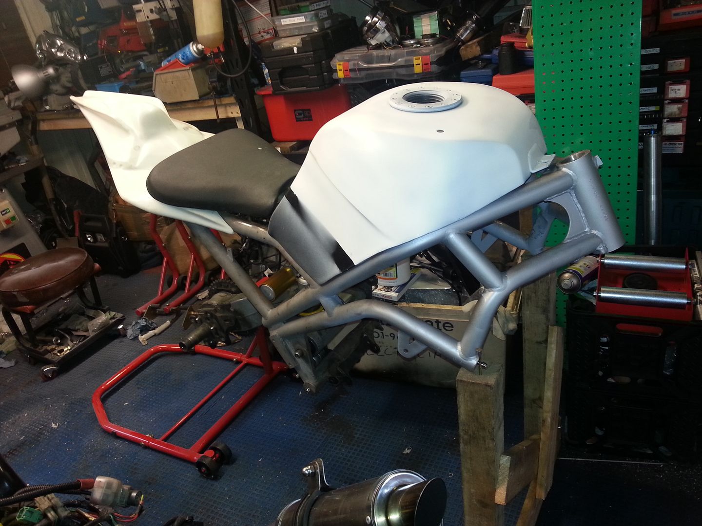

well i have sent a few parts down south , and my top yoke is oop north , now i am having dilemas about the tank .....
this is my first headache the .....massive exon valdize fueltank:nocomment:
then i thought colour was my best bet
still not happy :shakeno:

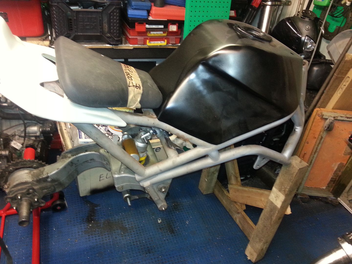

« Reply #31 on: April 29, 2013, 06:22:38 PM »
went to the breakers and bought an srad tank as i thought it might be the right shape too narrow
and also a mile off on the side view

i am going mental sitting in garage looking at the bike
bigger seat helps

« Reply #34 on: April 29, 2013, 06:34:59 PM »
a big job but i would be tempted to cut the top out of original and drop it a couple inches then get it welded back together and bodyfiller the line same angle as seat ?

« Reply #35 on: April 29, 2013, 06:37:43 PM »
back away from the seat unit issue and look at the stance , one more idea is to try yamaha tank cover idea of getting a fuel cell made :nocomment:

« Reply #37 on: April 29, 2013, 06:41:00 PM »
yammy tank looks much much better

« Reply #38 on: April 29, 2013, 06:46:35 PM »
the problem is the tank has an airbox for the gsxr 1000 engine , so its then a case of fitting a pipercross kit car air filter thing ?80 and loose the top of the airbox (can double up as electric tray ) then i nead a heal tech to sort the running these plug into the diagnostic plug to sort out the new mapping :freaked:

« Reply #40 on: April 29, 2013, 06:50:46 PM »
What about keep the massive tank but have a tunnel cut in it like spondon etc

« Reply #41 on: April 29, 2013, 07:01:37 PM »
the tank capacity is 10 liters at the most .2 gallon in old money..
its got a massive gap for air box , having a browes on the bay at some bits now:smile: if it was easy everyone would be doing it :lol:

busa ash ( spondon ish ) gsxr 1000 special
« Reply #42 on: April 29, 2013, 07:23:18 PM »
looks a lot smaller painted white

« Reply #43 on: April 29, 2013, 07:37:11 PM »
My first thought was to chop the rear out of the tank harris mag 5 style but if its a case of wanting to keep the airbox i reckon you could get a similar effect with paint, similar to what you've already tried but curved in the same way as the mag 5 cutout is

« Reply #44 on: April 29, 2013, 08:23:31 PM »
the rear of the tank is where the fuel is , and a bit in the sides and top .
slim i know what you mean about painting it .
