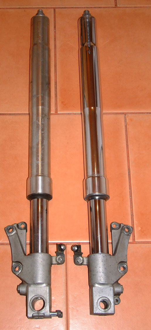

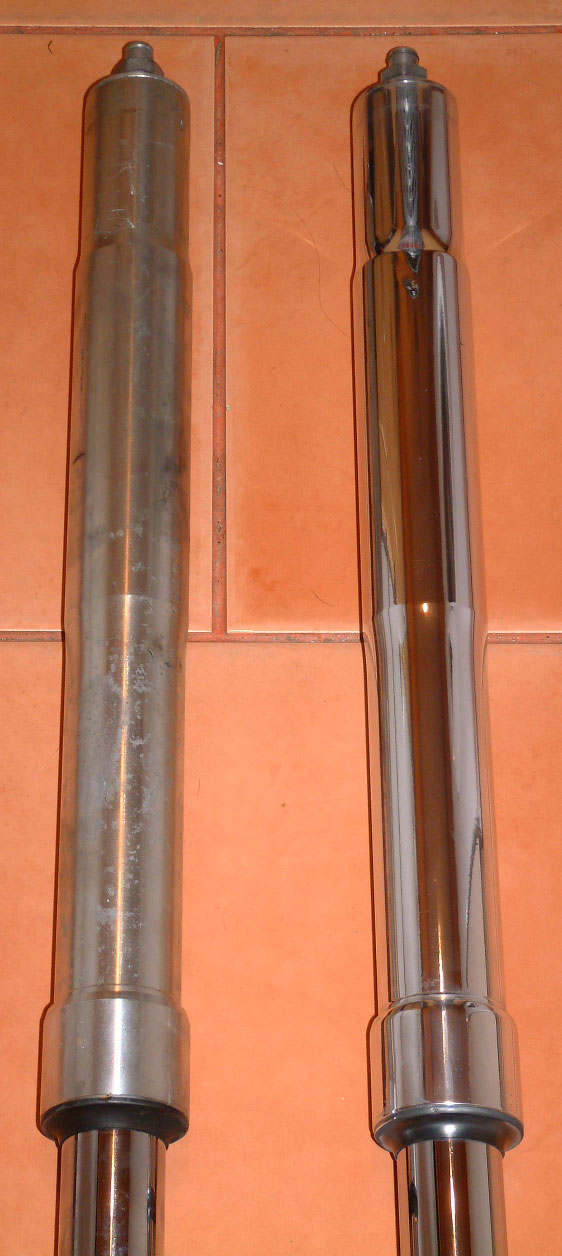

The forks were removed from the bike, and using the abrasive mops worked through cutting the anodising off, then 3 stages of polish were used to bring the forks up to a mirror finish.
The fork bottoms have now been resprayed in matt black
