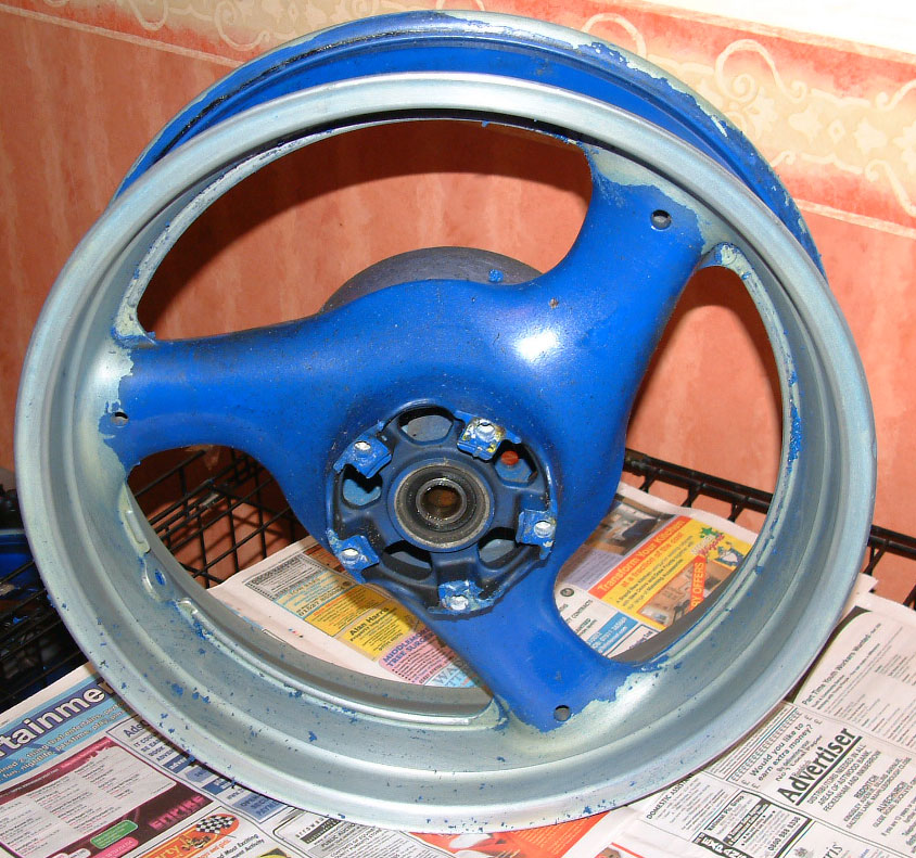

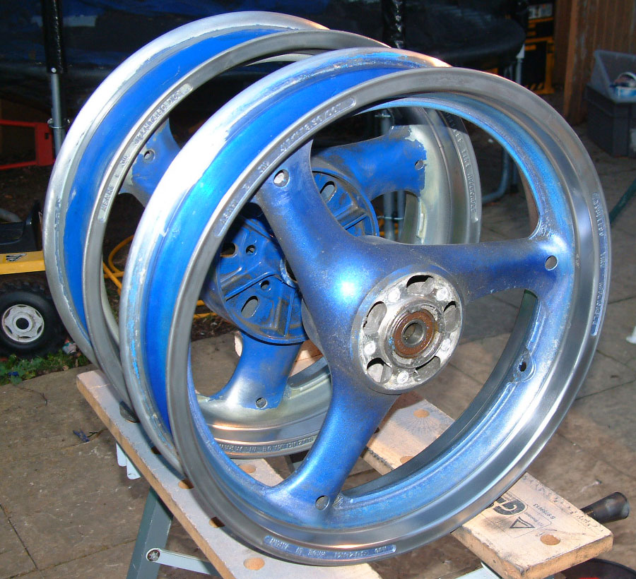

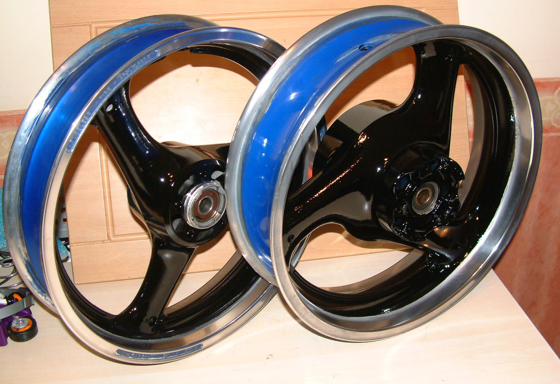

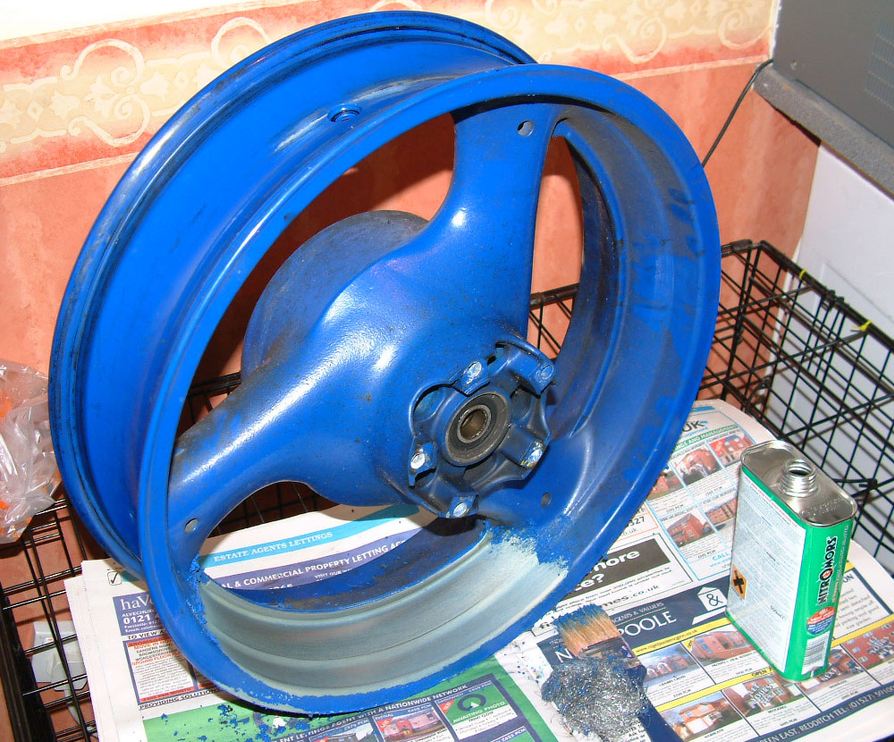

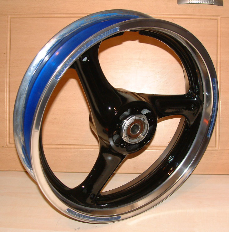

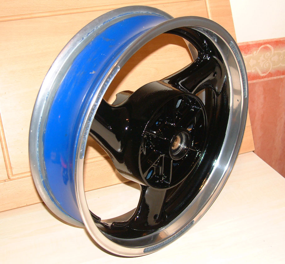

I started by removing the wheels from the bike, stripping the wheels down to bare minimum then attacked them with some Nitromors paint stripper and steel wool.Then i used 3 grades of abrasive mops, after many hours and a new drill (after burning the old one ou)t i carried on with the polishing mops.Once polished to my satisfaction i masked the rims off and sprayed them with 2k epoxy high gloss paint.
