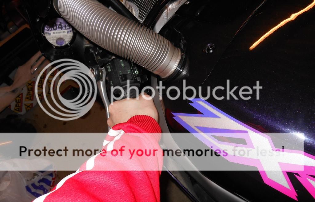

If you like i'll put my handlebars on full lock and take some pictures so you can compare?

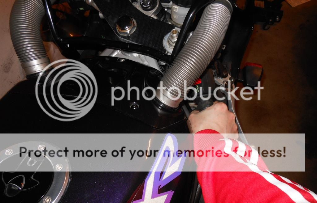

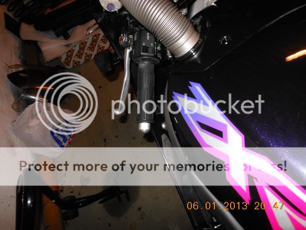

Laith
Posts: 5
Joined: Mon Sep 24, 2012 7:05 pm
My Bike: L8 ZXR400
Location: Aberdeenshire.
Re: zxr400 tight on full lock
Post by Laith »
Mine are quite close aswell on full lock, but theres enough room to get my hands on them comfortably.
Hope the pictures help a wee bit!

cheers mate . ah ur's is quite different being the newer shape Ur tank seams lower up front were as my tank actually bulges out over the controls thanks tho for taking the time to take the pics. maybe they are both bent like leey said i didn't even bother getting them off too check for straight as they both seam the same but its possible. ill get them off tomorrow if theres straight i guess ill just have to see what the mot tester has to say

THE PREVIOUS PICTURES LOOK LIKE AN L MODEL. RICH YOU SAY YOURS IS AN H. DONT KNOW IF THIS HELPS ANY. CHEERS BOBBY
