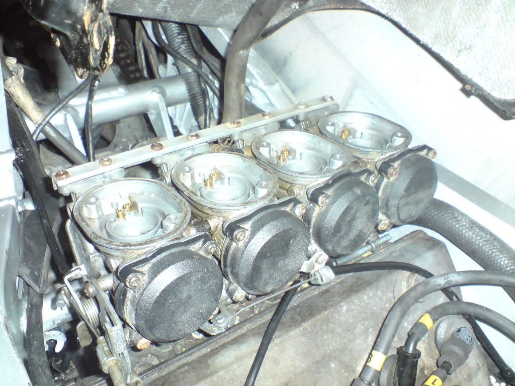

Well tonight ive had the carbs apart n cleaned them and put them back together and its no bloody different although i did notice that the rubber diaphrams inside the carb are a sod to get back in properly they seem almost oversized , possible they have been changed for ones that are the wrong size previous ? as most of the screws are a bit mangled so they have been apart a few times before . i try to push the outer lip into the carb surround then pop the plastic cover over and do up the four screws but every time i get them in when resealing the cover it seems to pinch the bellow bloody iratating .. anyhow got i back together something like it and there is still no action from the engine so next im gonna try some new plugs and see what happens..
you can see the rubber bellows not inserted properly got to try again to put them back proper
Re: ZX400G starting problem
get that battery fully charged and put a new set of plugs in and i'm sure it'll be sorted!
