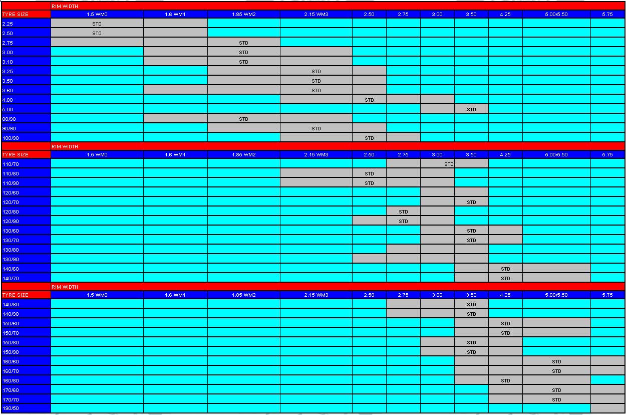

yeah, but the actual rim is probably about 3.5" wide which will take a max 160 tyre apparently.But you can fit a 170 on a 3.5" rim, if you look on the side of the rim it should tell you the rim size.Can anyone confirm?

I checked the writing on the rim, and it seems to indicate a 4.5" rim?

Rim Width/Tyre Size Chart
This chart has been compiled from a number of tyre manufacturers charts to give an overview of fitments possible, for more specific information contact your tyre manufacturer.
The shaded area shows the possible rims for a tyre size including the recommended fitment.
This information has been taken from the web and neither myself,zxrworld or zxr400owners club will be held responsible for any incorrect information, it is merely posted here for a guide only.

So, if the rim is indeed a 4.5", then the 170 should fit fine (if I am reading this correctly)? :smt017
Ride it like you stole it!
yep, although it doesn't show a 4.5" rim (bloody typical) it shows a 4.25" with a std fitment of 160 but possibility of a 170., anyway my rim is 4.5" and i have a 170 on it, have done for 2nhalf years now. :smt003
