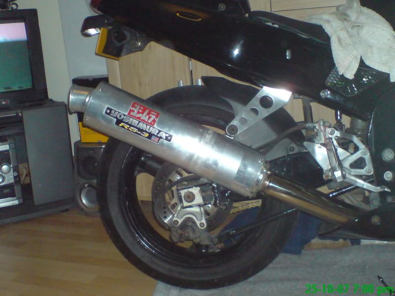

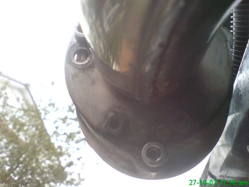

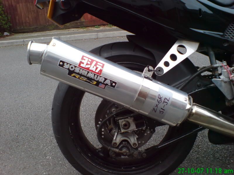

Got myself a new exhaust shame that it don’t fit.
It is only pinched on with one bolt in the picture. It’s off a 2001/2002 zx6r/636
Dean
Re: New exhaust
do you mean the 3 holes are pitched differently??

Re: New exhaust
Post by BANJO »
yeah and is a little bit wider

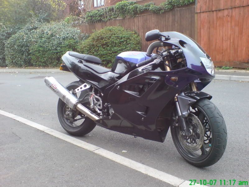

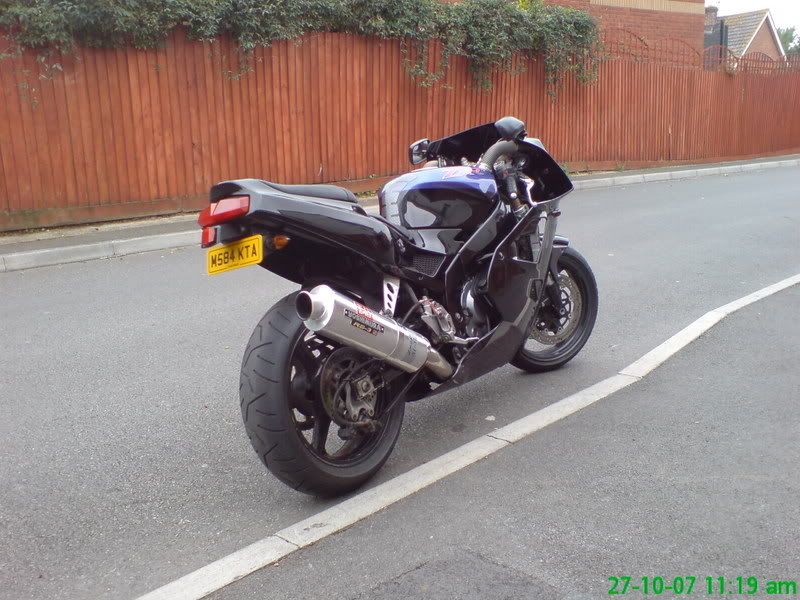

Re: New exhaust
Post by BANJO »

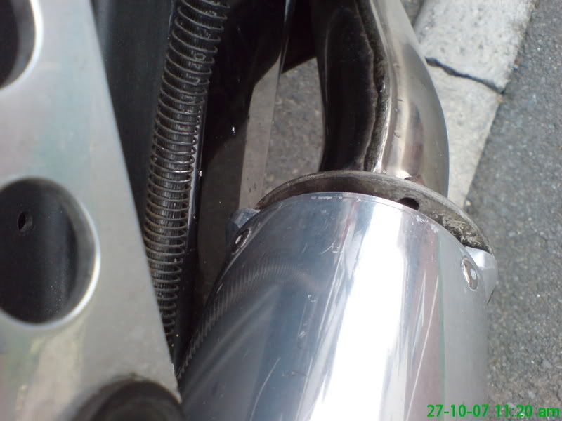

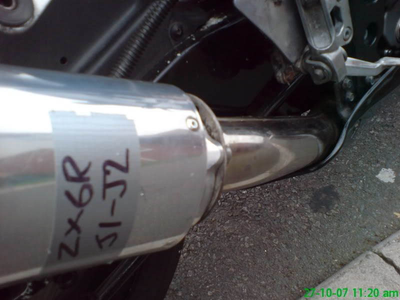

some better pics of the can on the bike and up close
dean
Re: New exhaust
bike looks much nicer now that you've got the rear end on again!
You can get adpters that go onto a slip on type link pipe that converts into a 3 point bolt mount. Could get one of them saw the standard 3 bolt mount off then fit the adpter.

Re: New exhaust
Post by BANJO »
Yeah i think the bike looks better with the back end on and the ninja sticker removed.

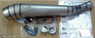

I like the sound of that adapter cos i would like to keep it and if i do IT will be cut in half i don't like big end cans the smaller the better.
I would really like one like this mini gp can £165 on eBay custom made

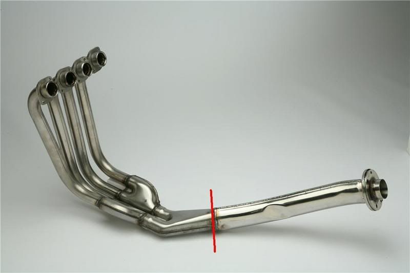

Re: New exhaust
Post by BANJO »
What about cutting the pipe right off see pic and welding a link pipe back on?
Or weld one of these things on
