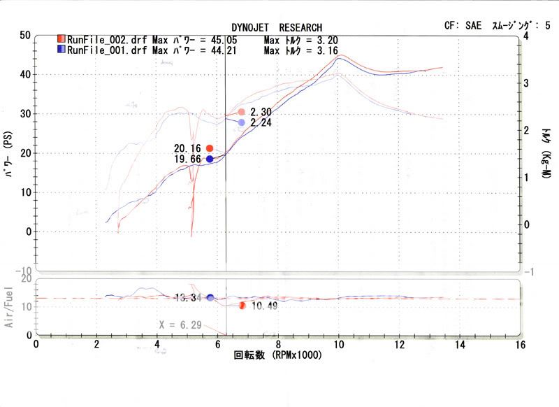

Well , initially I was cause as I was filming could hear and see what was happening :smt010
So once it was wheeled down I got to talking with the lads. That's when the smile returned !
Fuelling was near perfect and they complimented me on my set-up :smt004 They suggested a thinner needle to help the bottom end glitch but overall they just said keep it on the boil it's going very well :smt001
They would have loved to have seen it pull all the way through and were in no doubt that another 20~25 PS would be on top of the displayed figure. The fella on the bike is an FCR expert so I'll go and see him when I do the next set of mod's as he said he can set it up within a day no worries :smt004

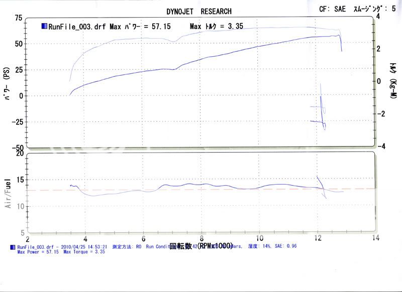

I hung around and filmed a few more bikes but I should have gone up the road and fitted one of the clutches laying in the cupboard just on the off chance it would be OK , doh! So i went back up the road - no problem with the clutch slipping gunning it :smt017 So when I got home decide I would take the ZRX down - a bit better this time:
Again they were well impressed with the fuelling, a bit lean at times but nothing critical and suggested that I adjusted the accelerator pump , they were stunned that they are running 160 mains for a 400 :smt003
5PS up from it's last run so hope that's the cam's and mild polish I gave the head , previous run was also good fuelling but bottom end had a huge whole in it
Although not as good a day as I was hoping it's still nice to know that fuelling isn't damaging anything except my pocket :smt002

Posts: 2320
Re: Dyno day Power check
be interesting to see what it makes when the clutch is fixed..
was he winding it on rather than cracking the throttle through the midrange ? only the graph seems a little low, even before the clutch slip came into play.
38PS @ 9000rpm compared to mine which shows 44PS @ 9000rpm and the ZX4 which had ~40PS @ 9000rpm .. and that was the middle of a horrible flatspot (since fixed)
Post by Mori Man »
Yeah, I told them unless they done a 2nd gear roll on not to bother cracking the throttle until above 6k as it would fall on it's face in 4th doing it - think that was 3rd they selected.
But once above the glitch he did crack it open.
If you look at the bottom side of graph it does pick up initially well so if that carried on the line would be well above shown , so if they could have cracked it on it would certainly be within what you specified.
The younger lad said for track it would work well as is cause never much below 5K and it is very close to the F3 spec' which I have worked from. If the clutch hadn't fooked up I had the F3 CDI and pulsar in my rucky with tools to swap over to do a back to back but no point changing :smt010
Crank is now back so will start the F3 engine soon and get it booked in with the FCR guy - his dyno and he's got a base line to work from :smt004
But really they said to me, no prob's to sort out and because I'm swapping out were happy to tell me how to cure the now :smt001
Really good talking with blokes who know their salt rather than just Dynojet fitters & fettlers :smt004
