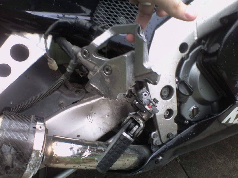

i'd be worried about the swingarm though!

a low side at 30 mph, the swingarm should be fine same as the forks unless he hit somat solid which stopped the bike, but if the bike slid, then its only mostly superficial stuff, get on ebay and barton breakers your soon start finding what you need, maybe buy yourself a new exhaust end can, scorpion make a luvly end can lol, bought one for my old 400 and for my current bike 636,

rob. look at the photo which has the swingarm and exhaust in.
look at the f*** off big dent in it.
consider my comment in the light of that photo.

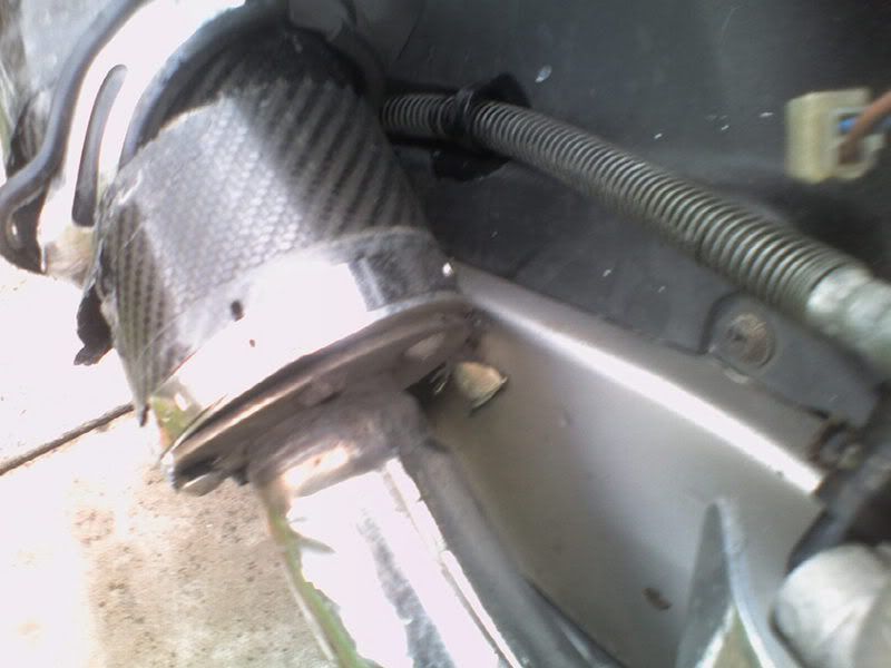

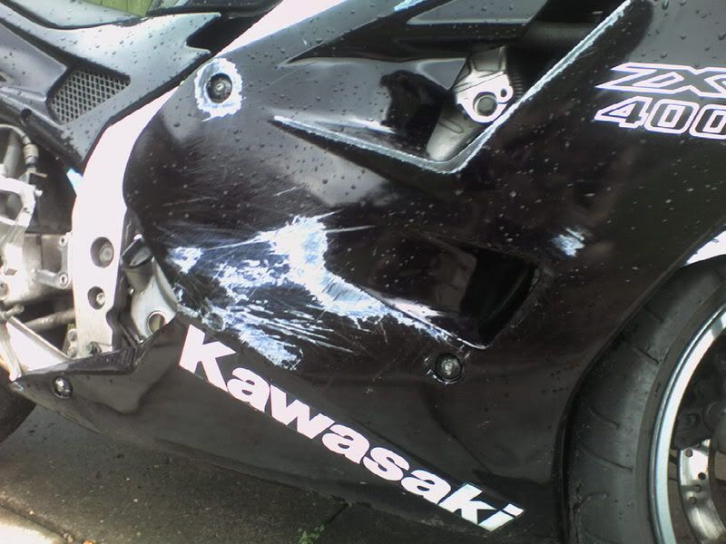

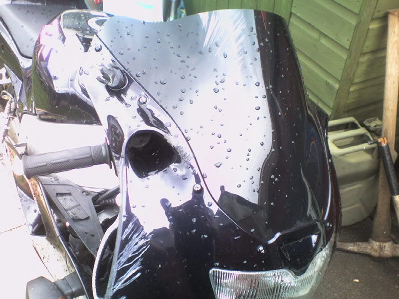

TBH the plastics you can sort, no real issue there. Soldering iron, plastic bars and sandpaper. Then re-paint.
New mirror £20 ..
The footrest hangers are designed to break.
I have broken one wheeling the bike out of the garage - they're made of soft cheese.
Again £10-20 on ebay.
The can you can fix, just stubby it and use a rivet gun to re-attach the end.
The swingarm will likely be fine, but if not you can pick one up off ebay or from a breaker for £40.
I got my H2 swingarm (non braced) for a whopping 99p off ebay. :smt003
A weekend's work ..
Chin up!
It would be a write off if you claimed tho ..
Up to you init.
I'd write it off as a cat D and then fix it or break it.

ouch, that's a helluva lotta damage for a 30mph off!
Is it the photo, or do you have a dent in your swing arm?
mirror/hangers/plastics - all easy to repair/replace - shouldnt take too long at all to have you back on the road.
Invest in some R&G crash protectors - they'd have saved most of the damage there. I learnt the hard way and fitted them after I had thrown it down teh road!

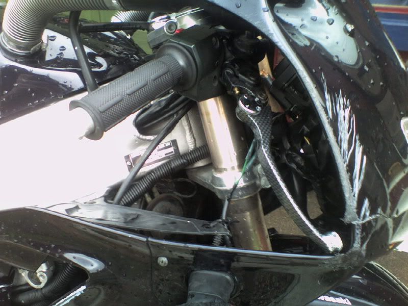

Hmm, is that the forks or the frame thats buggered?
Unlucky mate, have a look at it in the morning and it wont be so bad! Get it in the shed, strip and see whats to do.

the frame has a dent in is aswell as the swinger, which is why the front wheel is so close to the fairing, is it worth getting the frame straightened? or jus sell it for cheap on ebay..

You can buy a new frame/sub frame and log book for £75 off ebay.
There's a guy who sells nothing but.
