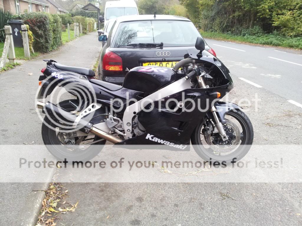

See if this one works

Bike looking really good. If you're replacing O rings and gaskets, check airbox and carb holders too. Viton kit has one set of these O rings, damned if I can remember which though.
Black wheels always look best, FACT, unbiased view of course.
