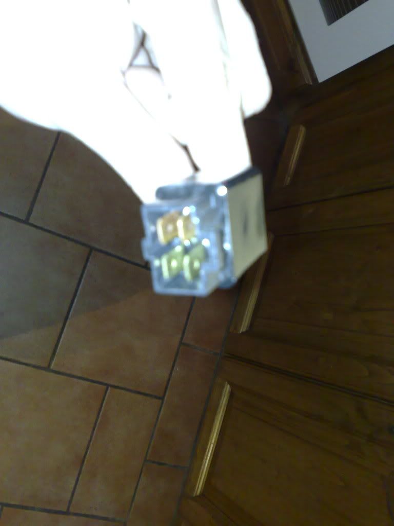

yea all indicators have stopped working.......check the pic out thats wat i replaced i dont no if its the relay or not.... and still noffin!!?

Doesn't the indecator relay only have 2 pins at a 90 degree angle? That to me looks like the fuel pump relay? If all indecators have stopped functioning then I'm pretty sure your indecator relay has had it.

I replaced the relay! the 2 pins at 90 degree!!
and BANG! indicators again! no more hand gestures!!
Thanks Guys! good man rob!
