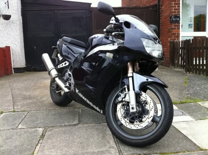

here is my bike when i bought it guys

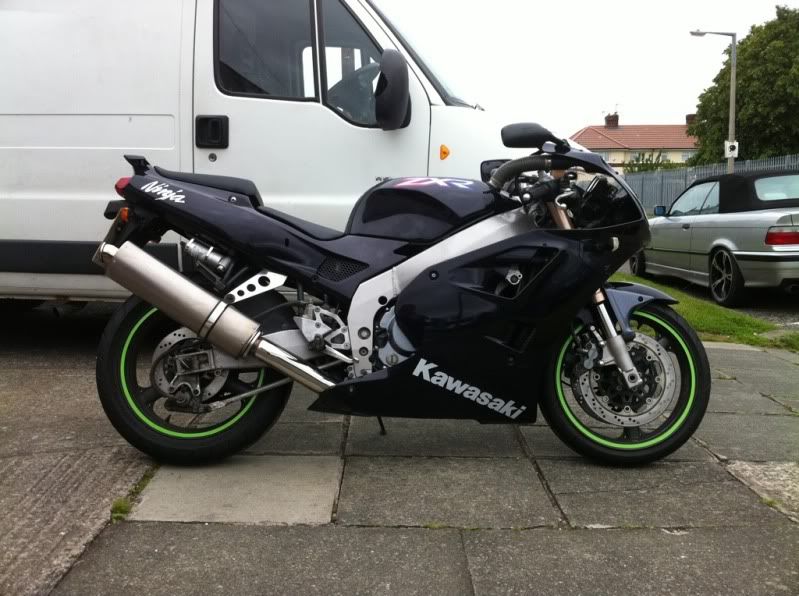

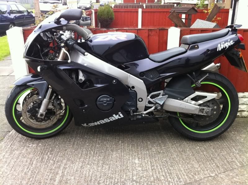

just made two mods up to now as i didnt like the 400 sign i changed it to ninja, plus got green around the wheels
on this picture you can also see my bmw convert
next on my list is to change the horrible looking back reflector and licence plate light, im going to use led's to light the licence plate up and modify the reflector to the bottom of the licence plate. thanks

Rimtape is for gheys and girls.
apart from that, its a nice bike

Is that a H shock on a L?

That's an SP shock wether it be J or M - well worth having it serviced BTWwildkid wrote:Is that a H shock on a L?

haha im not sure what shock it was? what is a sp shock? plus have you got any pics of your exhaust? i want a new one anywaywildkid wrote:ooo niceMori Man wrote:That's an SP shock wether it be J or M - well worth having it serviced BTWwildkid wrote:Is that a H shock on a L?
Re: new member 1st zxr400 l9
SP shock has three way adjustment on it:
a) Pre-load , the adjuster ring above the spring
b) Compression damping , 4 way adjuster at bottom of damper rod
c) Rising rate , set at remote res' - think it has 12 clicks
Set these up right and the back end will be like on rails
If it's never been serviced then new seals , bushes , oil & gas will transform it - should be done every couple of years to keep peak performance.
