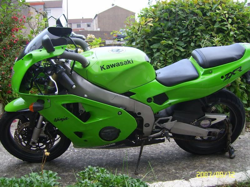

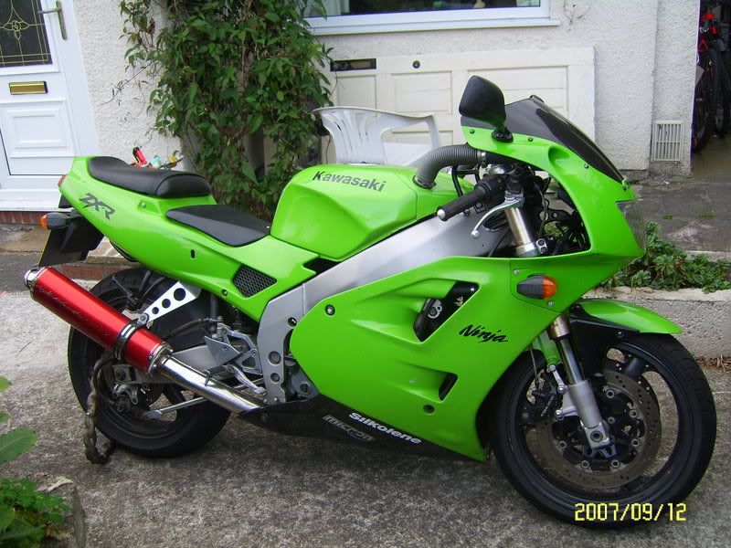

thanks for the welcome ive only got 2 pics and a short sound video. i paid £400.00 for the bike witch is in pretty good condition apart from the overheating and a bit of damage to two bits of fairings ill get some more pics when i get the fairings off
