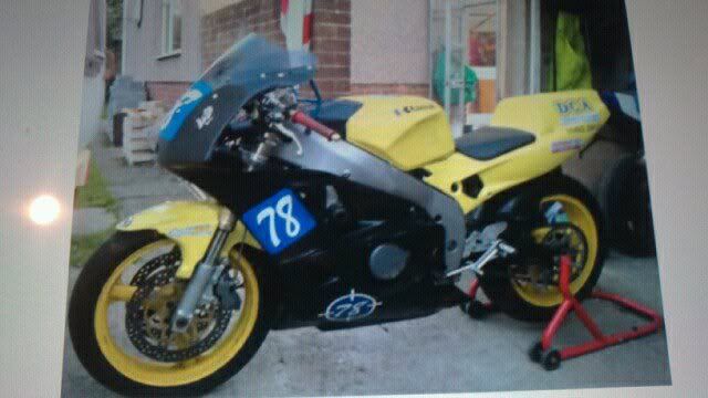

Got it off a guy between Abergele and Colwyn Bay, quite high up the hill. It looked a bit of a shed, but as you say has all the right bits on it including maxton suspenders, usual race garb like rearsets etc, so my thinking is it wouldn't take much to make it good. Mainly replace all the cable ties with nuts and bolts, sort out all the bodges and it'd be good. If the motor is right, that is! I'm not fussed about stripping and rebuilding the motor, infact I'd prefer to as it seems to be a bit incontinent from some of the surfaces, not a great sign. There seems to be numbers on each cyl. 50.6, 50.4 etc. What are these all about? Written in marker pen..
This is the bike as it was bought... Lovely colour or what!
Sorry for the shoite picture, we'd stripped it for painting within 10 minutes of removing it from the van!

That from a guy called steve? i think that was his name..
that bike was at dynopro for a while a few months ago i think, whilst it was up for sale..
I remember it looked a bit rough around the edges, but all there just needed a few quid spent on it.
Im not sure what the marking on head would be, poss compression? why someone would write that on the head tho i dont know.

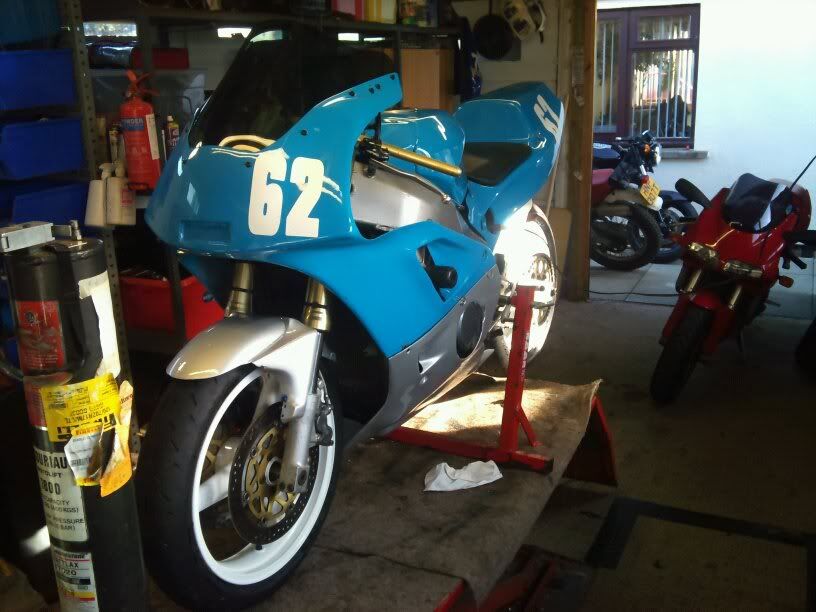

Here's how it's looking now..
Nearly there.. new bodywork would be great but lets see how the rest of it goes first eh!
