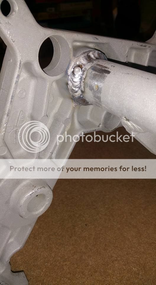

This was one of the main roadblocks for the project, most places that I took the bike to wouldn't attempt this repair,but I found a local fabrication company willing to give it a try. With this renewed confidence I set about fully stripping the bike.

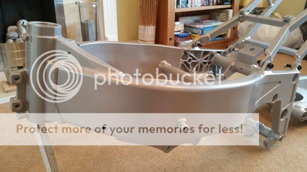

With the frame stripped I could get it blasted ready for welding

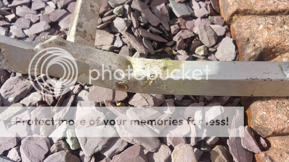

Another slight issue was this bent sub frame, as a new one was 20 quid it was worthwhile replacing rather than repairing.
New subframe, new vs old,just a matter of swapping over all ancillaries
Getting the frame back from being chemically stripped at a local blasting/stripping firm (Midlands Coating Removal Process)

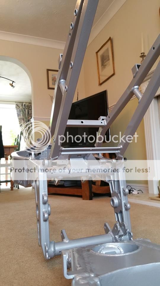

With all the paint removed the weld could be redone, for the pricely sum of £20.

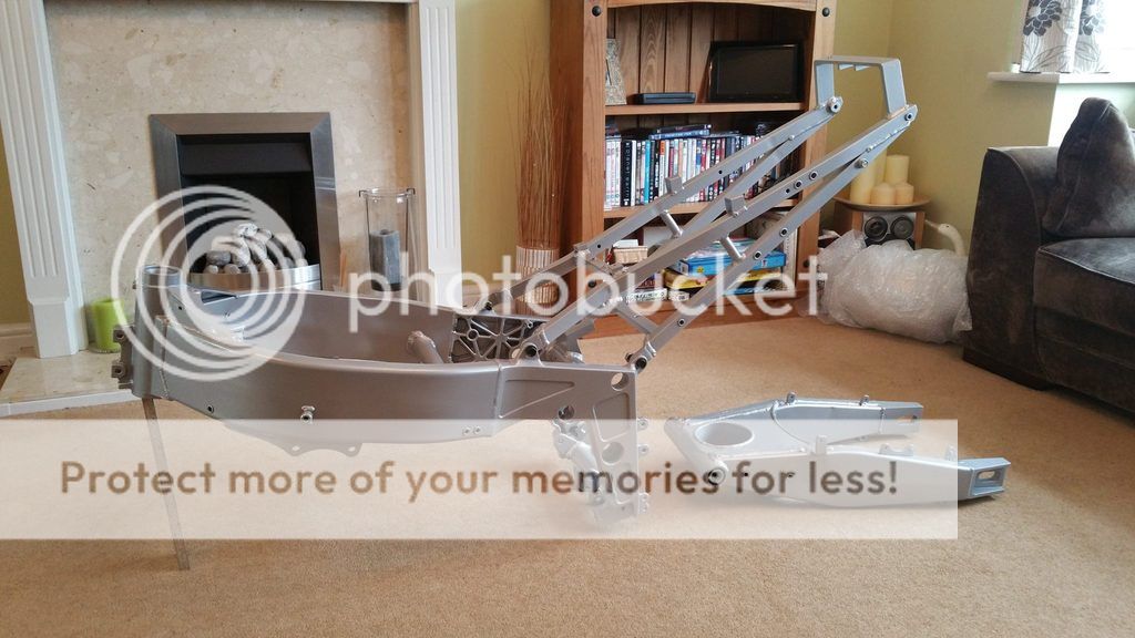

Ready for powedercoating!

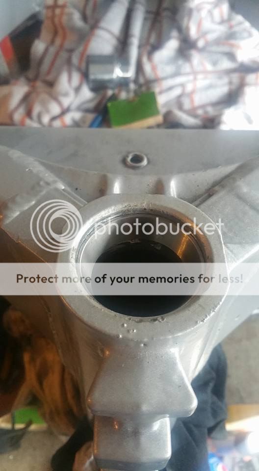

After a struggle all the bearings came out after years of siezing into place.

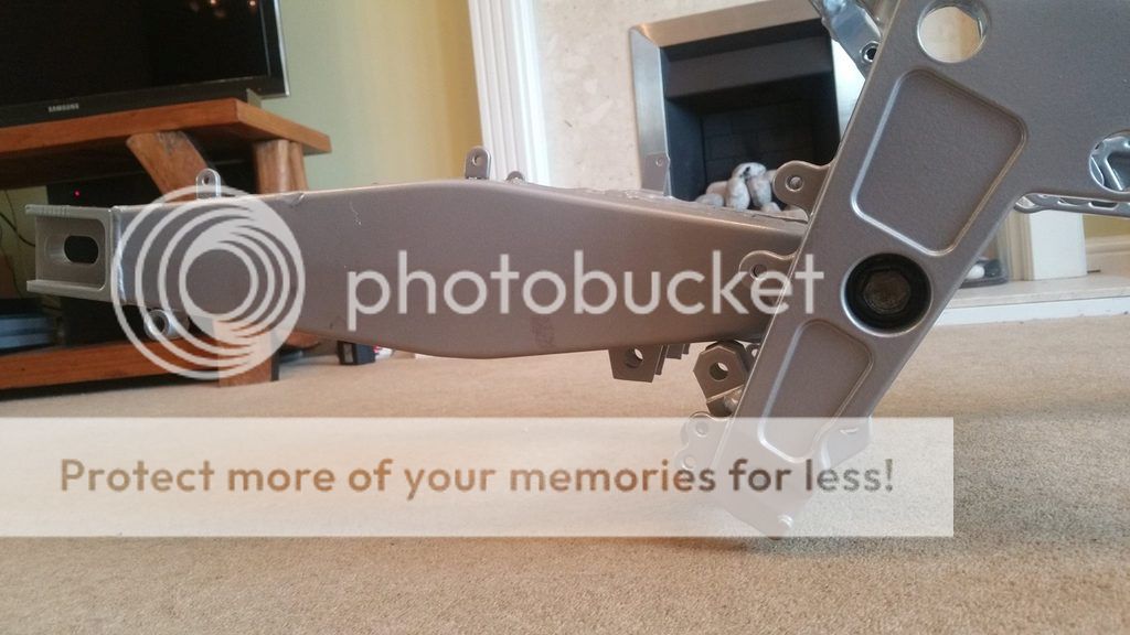

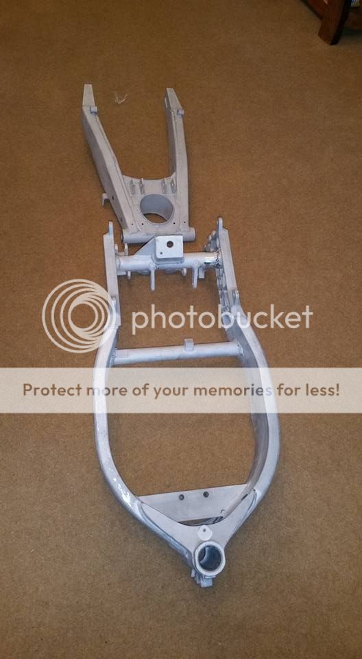

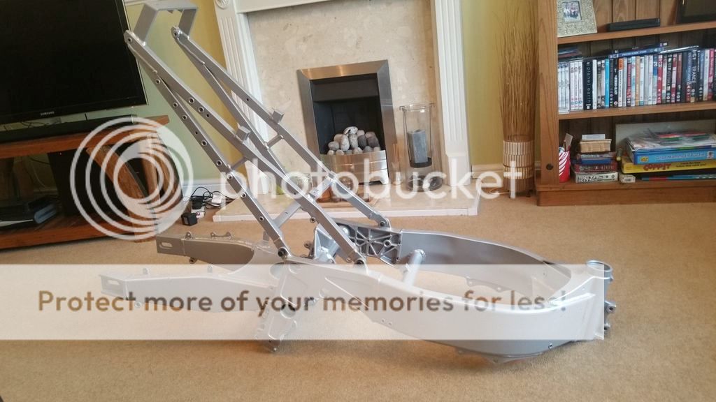

Subframe loosly bolted on to check fit, now the Swing arm needs new needle bearings. Whilst it is so far disassembled it is worth biting the bullet and getting it done now, not a bad lookign frame considering it is 26 years old!

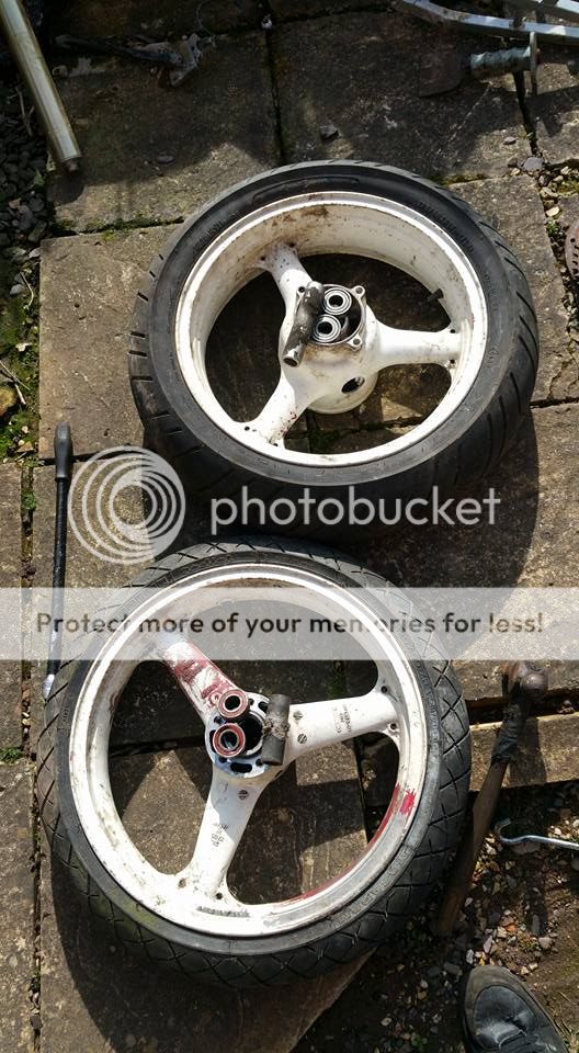

Now I dropped the wheels (after tyres being removed by Sticky Lee, in Shifnal,Telford) off to be blasted and powder coated whilst I got on with the swing arm

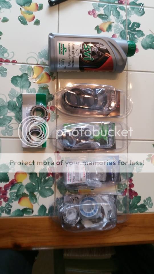

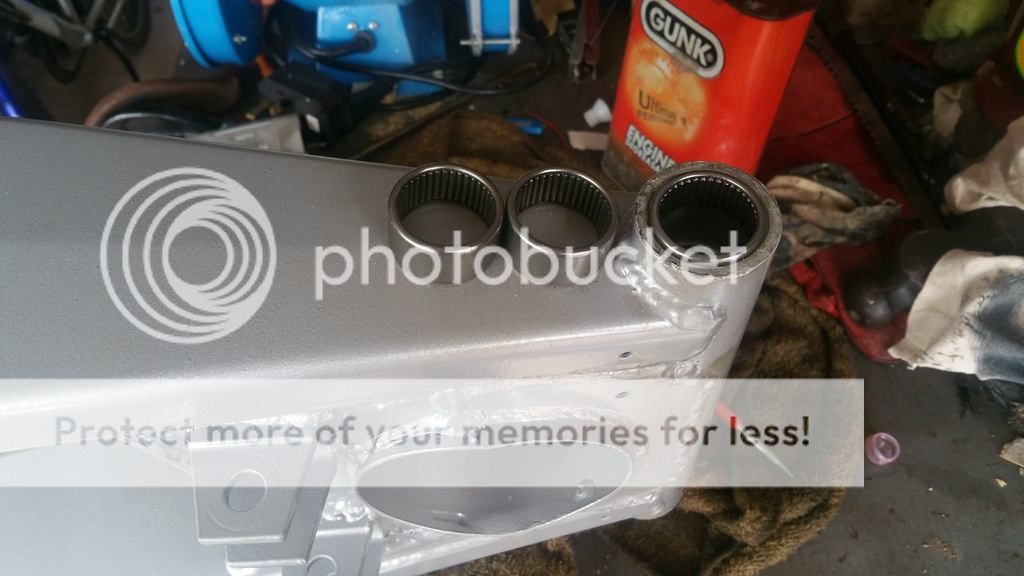

New bearings for the frame and wheels
Driving in the new bearings-
All tourqued up to spec.

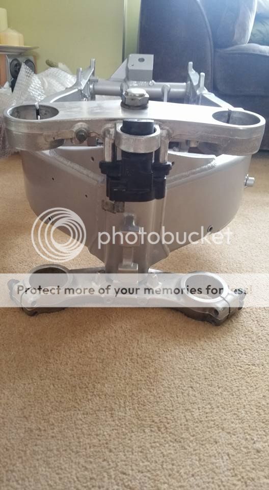

After a struggle, and more help from sticky lee the old headstock bearing races came out, the new ones went in much easier
New headstock bearings fitted after a slight clean of the tripple trees

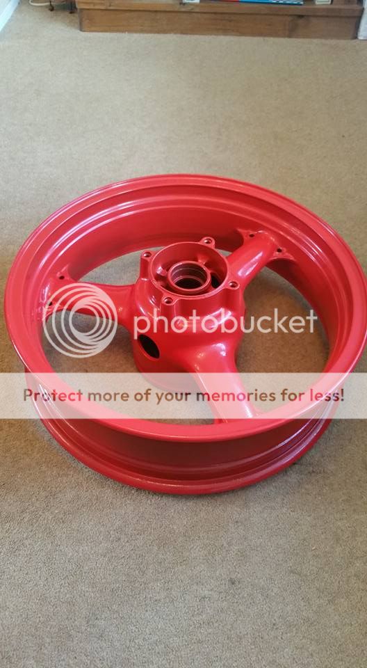

Wheels picked up, going for what I believe is the original paint scheme, Red,Black and Ebony.
Old suspension was completely shot,so replaced with new where available.

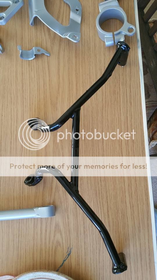

Starting to get to know my powedercoater very well! With new bolts I can start to reassemble.

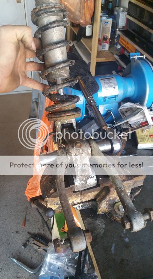

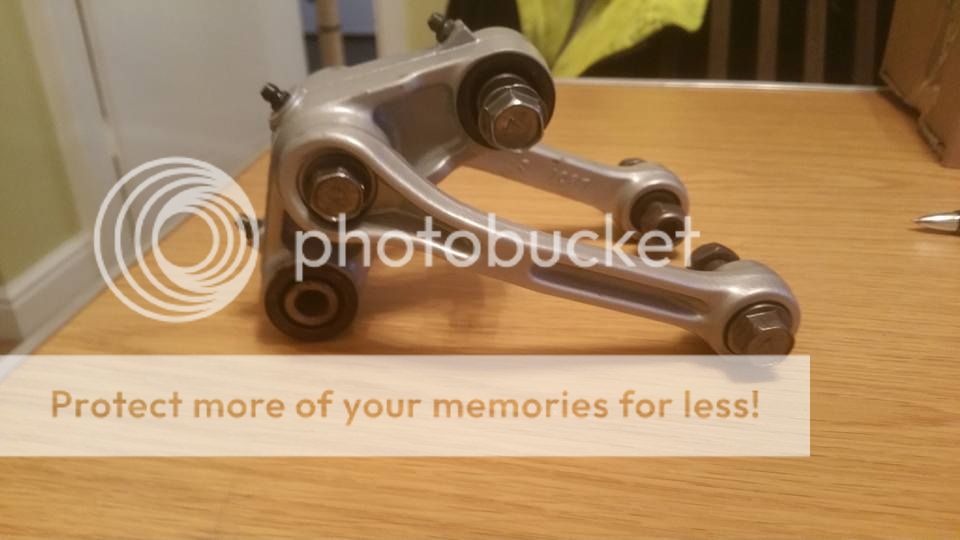

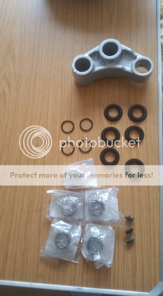

The rear shock linkage appears to be beyond recovery,so new bearings,o rings and seals ordered for a full rebuild, this is how it looked after 8 years of being sat in a garden.
And stripped for rebuilding
Ready for reassembly

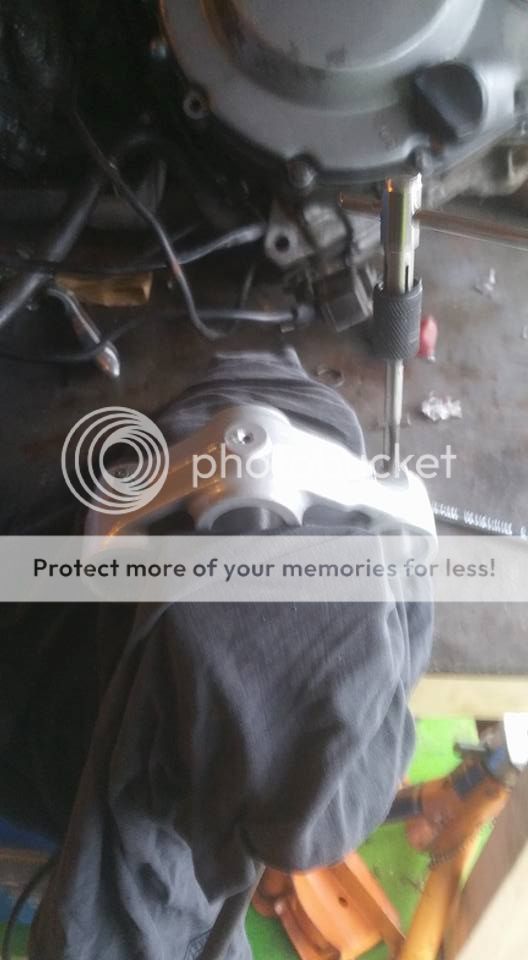

Clearing out the excess powdercoating with a tap
New bearings and seals
Now assembled with the rear swing arm attachment arms,will hopefully be ok for another 26 years!

Looking good there mate. I noticed however, that a number of brackets were bent after being powder coated which may cause the paint to flake off when you attempt to straighten them! A minor observation, but none the less the job seems to be going well.

They should come as a pair although I only saw one on the table with all the parts coated in silver and it was one of the brackets that secures to the main spar of the frame, securing the side panel. If you look closely you will see that the sides are folded in! You can bend them back, but they'll never be perfect unless you've got OCD!
The others to watch out for are the two brackets that hold the wiring loom connectors from the main loom to the switch gear connectors and attach to the front sections of the frame. They twist and bend quite easily.
Any fairing brackets will bend easily enough if the bike had been dropped and I've had some that look fine until you fit them and then try to connect the fairing!
