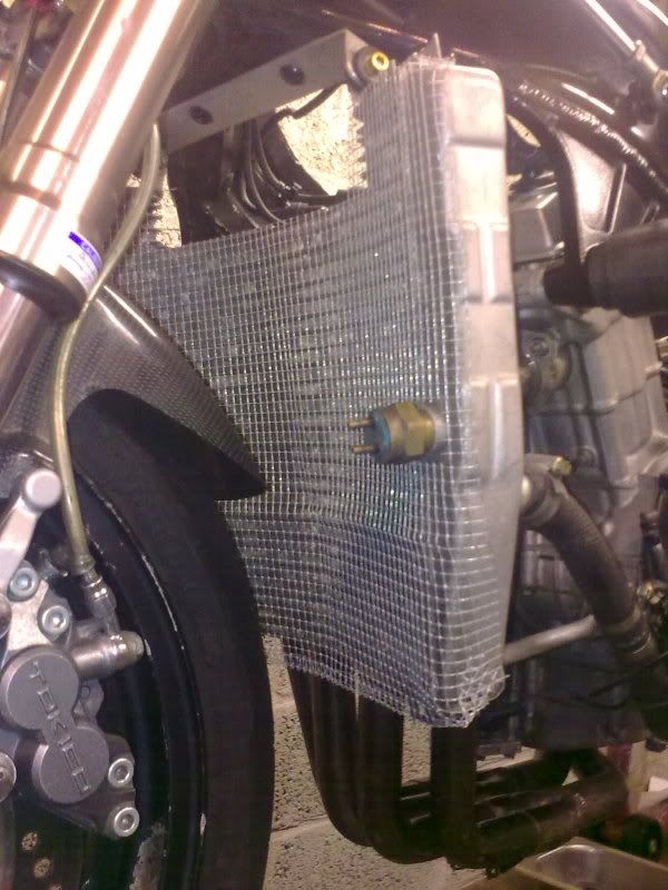

Just remembered that I took a picture of one of my bikes with oil cooler removed..................it even looks better without it

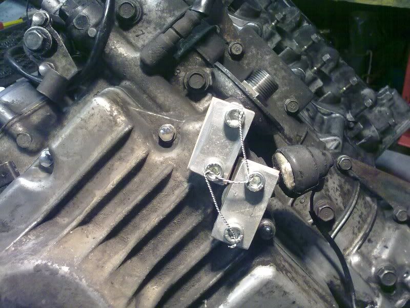

And here is my solution to the holes left behind after the cooler is removed.
Not specially pretty but functional

Thanks for the pics. Nice job. Just out of curiosity has anyone weighed the cooler & lines to see how much of a weight savings you get?

Your safety wire job is killing me and doing nothing for your screws. They can easily loosen a half turn and leak everywhere.

Fair call it's not aircraft spec lockwiring or drilling............................
But then there is no requirement in race regs for them to be wired at all and certainly Mr Kawasaki doesn't wire them neither does Mr Kawasaki require thread lock...................yet there does seem to be a history of oil cooler screws removing themselves................or at least the 3 guys I spoke to who run ZXRs have had the same problem I had last August.................mine have thread lock and the wire was just a bit of belt AND braces...............take it from me they will not "easilly" undo....................£100 to my favorite charity if they do.
