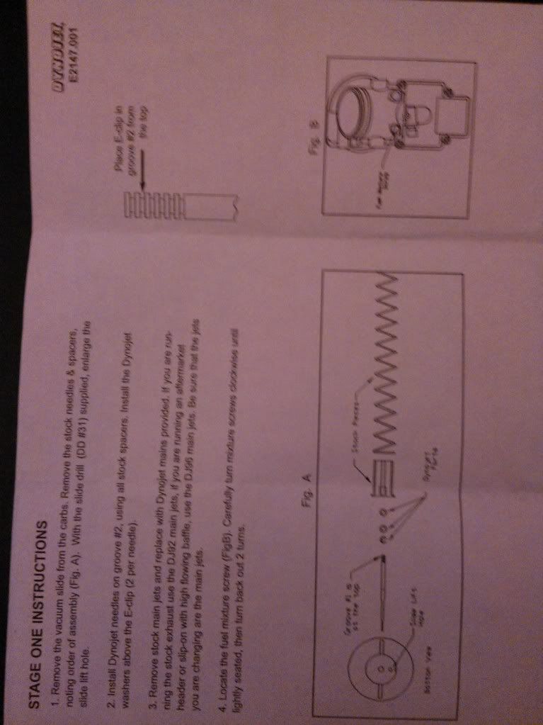

Don't know if its any use to you anymore but I found the instructions, hopefully some people will find them useful

hopefully these will help some people. asked dynojet what the washers are for, the gaps between the grooves is 1mm, the washers are 0.5mm so that you can fine tune your bike even further, they say to put them on top of the E-clip so that they dont get lost
