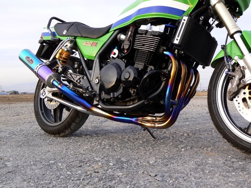

1st road test
Post by Mori Man »
Start of rainy season today so was up and out early before it started to piss down :smt011
The front wheel got a new tyre fitted on it on Monday so it was sitting ready to go on;
I went round and checked all my fixings for secureness and placed the ignition barrel under the seat. No clocks fitted just now - all will be revealed later! As you can see the muddy also went on in it's primer coat to allow me to have a run before the rain commenced;
This is a rough build just now to get that 1st road test in and iron out the bugs over the next 4 weeks of rain. Come end July I should have nearly all other parts in place to finish but I will have cured all the little niggles like the "lock to lock" is too small and I need to do a 20 point turn!! Locate the ignition barrel for more practical use.
The performance already is stunning and I can't wait to start dialling in the suspension to bring out the best in it :smt003
Rear wheel will need to wait until my existing tyre is a bit more worn as it is only 3 weeks old.
What it might look like nearer the end;
