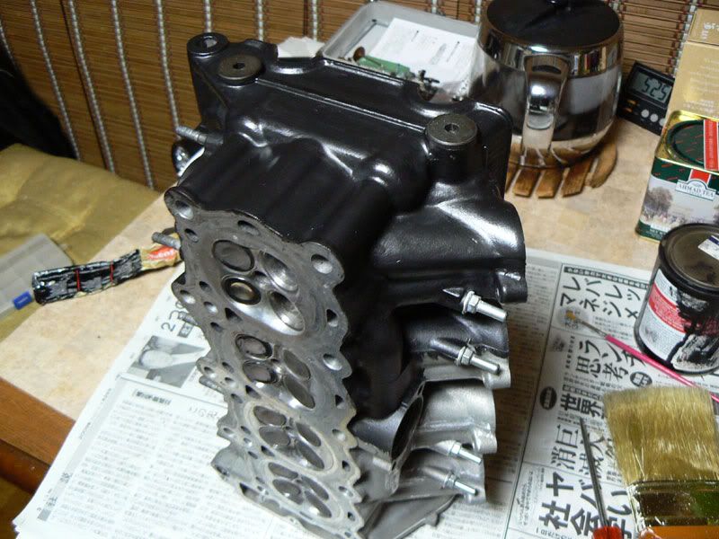

Weather been a bit poor lately so haven't been able to tackle the frame, wheels and swinger so I've turned my attention to the cylinder head as that can be done on the kitchen table :smt003
Armed myself with a rotary grinder / polisher kit and bought a valve spring compressor too:
The timer is so i don't run it for too long, they recommend 15min max so i set it to 10mins.
1st task was removing the rockers - very easy to do after removing the two side bolts that hold them in place. after that I slid one of the rockers and the end of the shaft popped out enough to grab and pull straight out, your then left with the rockers sitting in place with the springs. I've marked up a sheet and kept them in order and will be bagged accordingly.
Will do all the head work with the valves in place then remove when doing the ports - removed two just now so you can see what's happening.

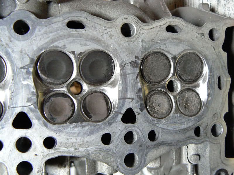

Cylinder Head:

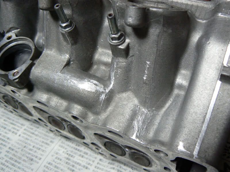

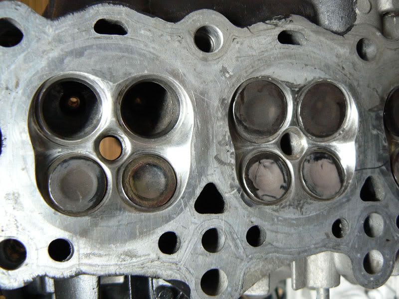

From the factory the finish isn't the best and indeed the combustion shape is also a bit rough too, so I have started to smooth out the casting and re-shape the chamber;
If you imagine a river with big boulders in it and how much disruption they cause to the flow then that's what's happening inside here too - removing these obstacles creates a better flow and the chamber can fill / empty quicker and more efficiently;
I'm not going crazy with the removal of material, just enough to clean up the rough casting. I am also removing the material from around the valves (left there from when the block is cut to fit the valve seats) which again helps gas flow. I am doing this by hand with a new Stanley blade which shaves the alloy very easily and controllably ;

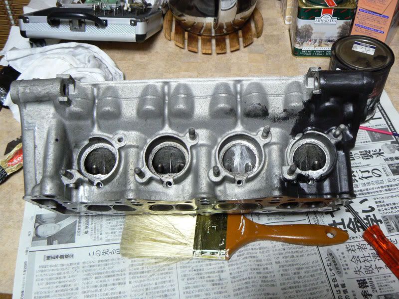

Once I get all the "ruff" work done then I can start getting it polished to a mirror shine including the valves, they will finally get "lapped" back in when I do the re-build. All components including the head will be placed in a bath of cleaning solution and blow dry with an air line to ensure all traces of swarf are removed. Piston crowns will also have the same done to them :smt004

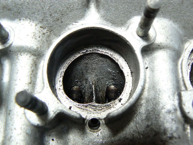

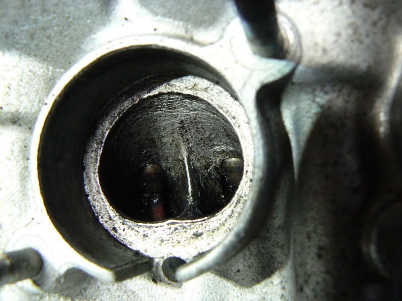

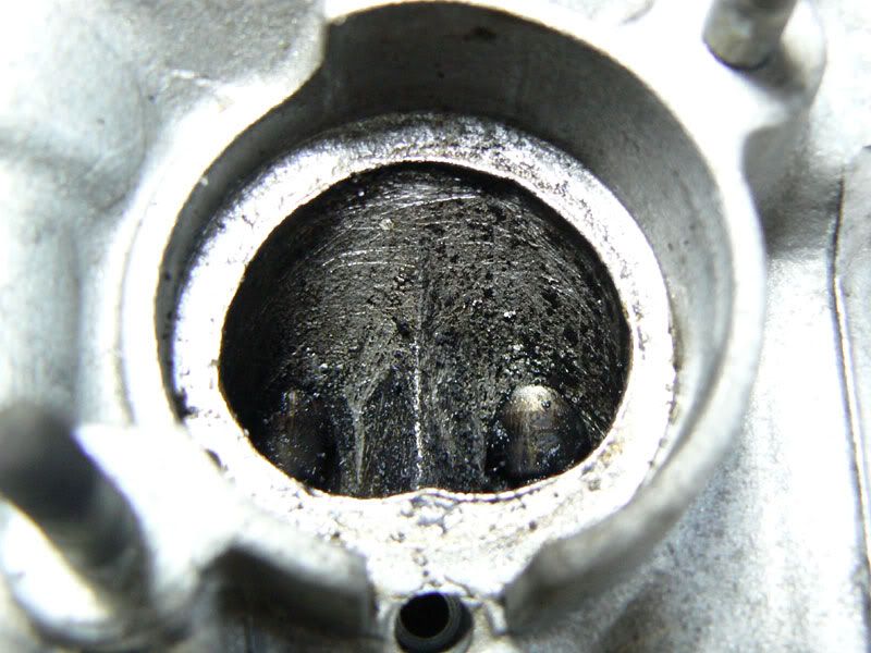

Inlet / Exhaust Ports

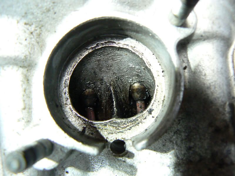

Here you can see the rough casting lines and indeed casting blobs in the inlet tract, again all I am doing is smoothing these out and not removing vast amounts of material as my aim is not to drastically change the character of the port. Once all the cleaning has been done these will also be polished as best as can to promote a good clean fuel/air flow and emission.
Only just starting with this but should be worth while in the end;

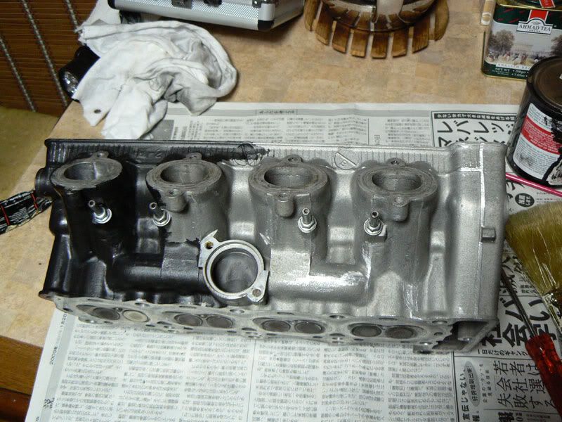

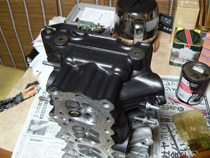

Been picking away at the head each night for an hour or so before the wife gets home :smt002
Made good progress and now down to polishing each one up. I ordered up some industrial parts cleaner (a bit like sugar soap) and that arrived last night so today I made up the solution for de-coking the exhaust ports before smoothing them out and polishing.
Stuff works a treat and also removes that Tan colour from inside the head and while i was waiting for it to do it's job I attacked the outside with a "brillo" pad
From this:
To this:
Next task is to clean up the SP engine the same :smt003
